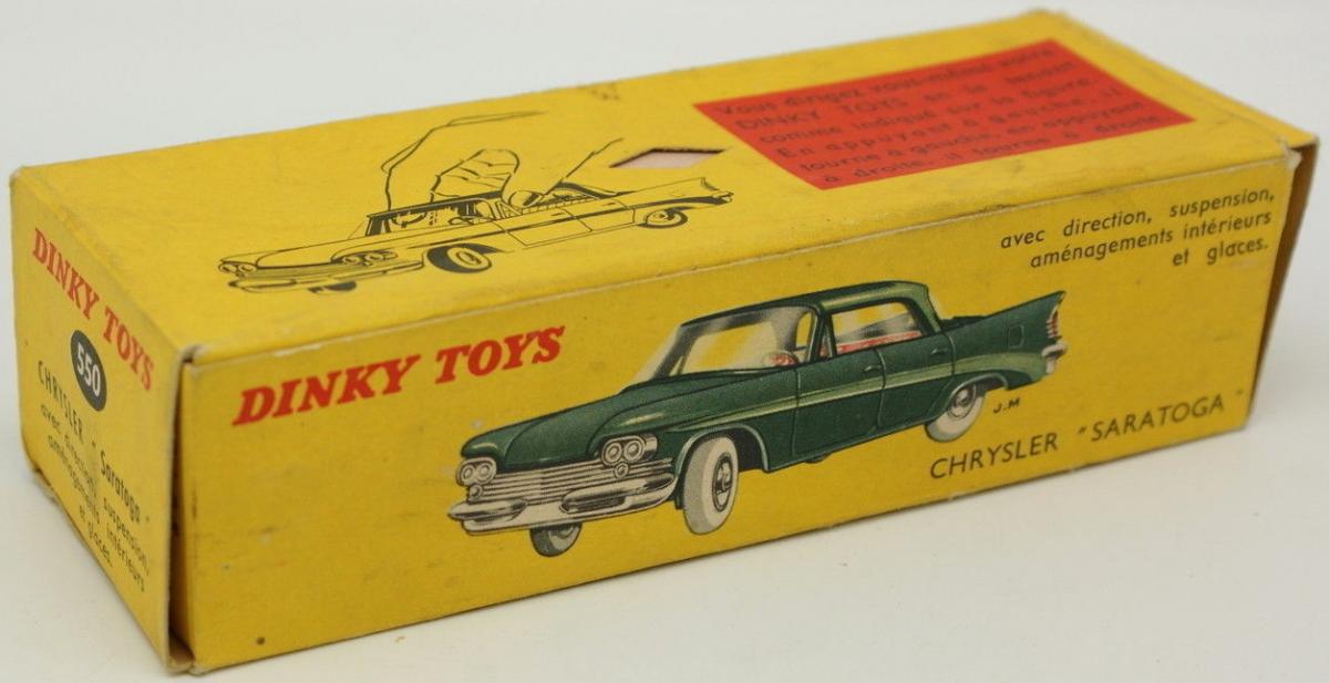

During the whole production of the Chrysler Saratoga the model is on his yellow box pictured in the never issued colour green.

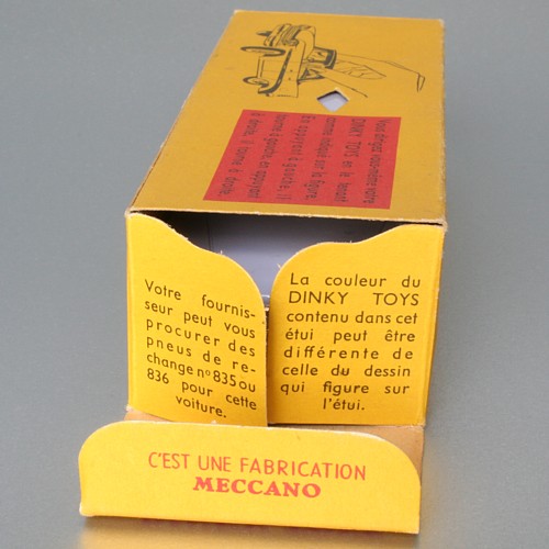

Fortunately there is an open diamond in the box through which you are able to check the colour of the inside model without open the box. A typical French practical solution for this kind of problems.

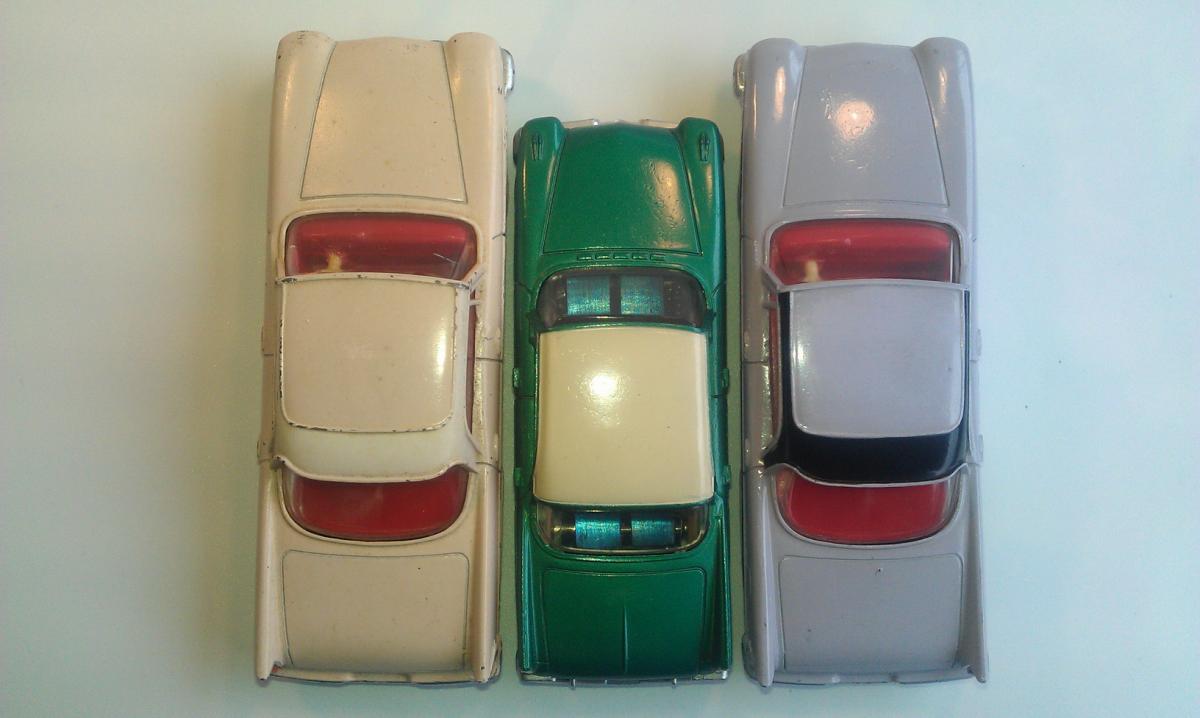

The size of the car compared to the other DT USA cars from that period strikes immediately. He is much longer, wider and higher than the others. Jan Werner has already explained this on 26-4-2008 in TMT in scale mathematics, but I'll made this visible with pictures in which I place a French 545 De Soto Diplomat (also of construction year 1959) between 2 French 550 Chrysler Saratoga's (construction year 1959) for comparison.
The 550 is 129 mm long and the 545 is 113 mm long. That differs 16 mm in length.

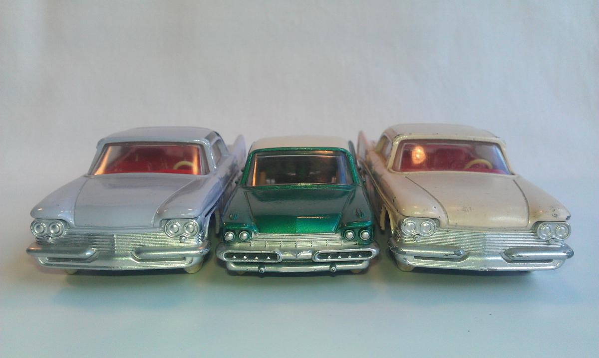

Comparison of Chrysler Saratoga (outside) with De Soto Diplomat (center). Helicopter view.
Comparison of Chrysler Saratoga (outside) with De Soto Diplomat (center). Front view.

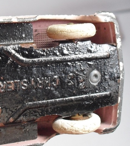

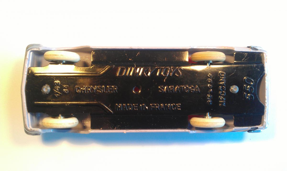

I like to mention here Jacques Dujardin's remark in TMT: On the base plate, the ref. number is stamped in slant numbers which is very un-usual.

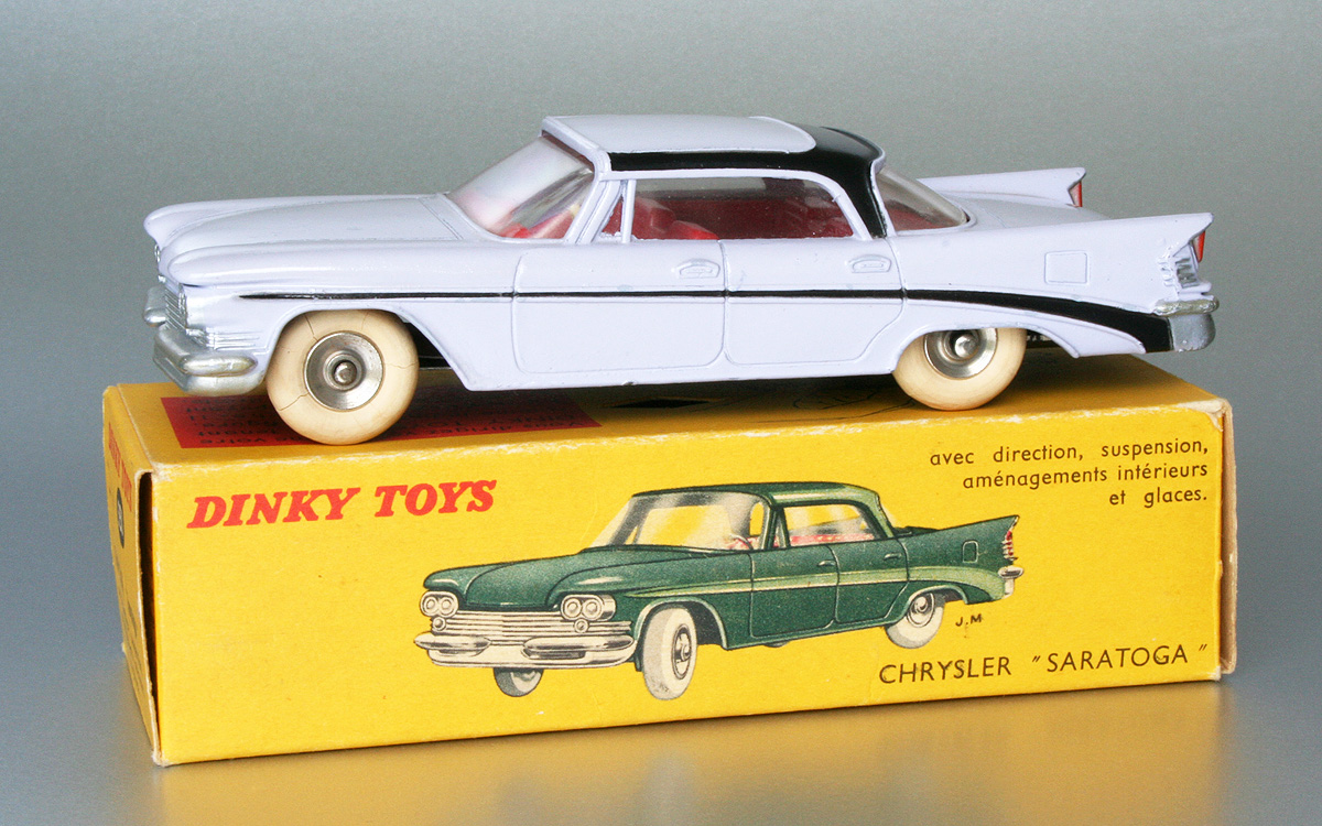

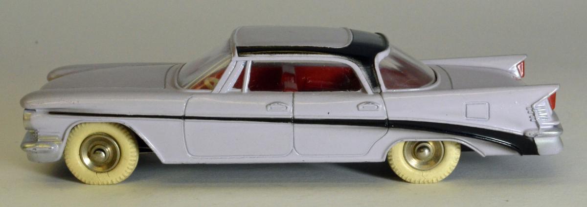

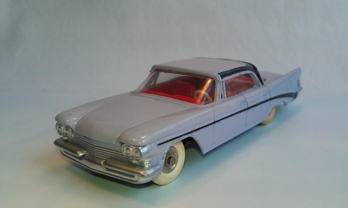

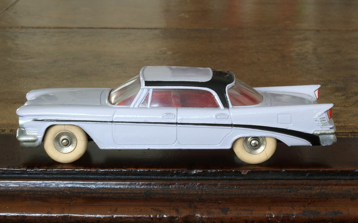

The model is issued from 1961-1965 with plated concave hubs, smooth or treaded white tyres, windows, spring suspension and fingertip steering in the following colours:
Pale pink with white flash
Deep pink with white flash
Violet with black flash.

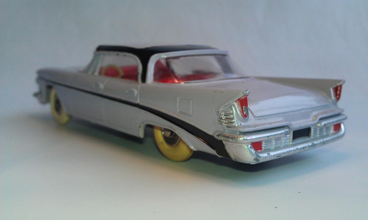

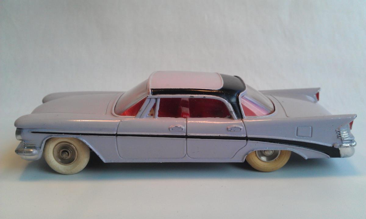

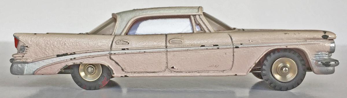

I made some new photos demonstrating that the suspension on the rear wheels is so feeble (or the weight is so uncommonly heavy) that it stands lower on its wheels than desired. This annoyed me already when I bought it 55 years ago. My photos demonstrate the difference.

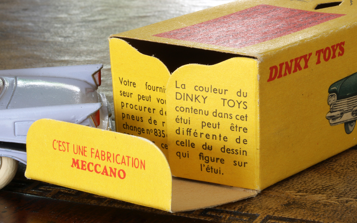

I also made a photo of that rather unuseful remark on the inside side flaps that the model's colour may differ from the picture on the box. Indeed it does, but that is easily seen through the little open diamond in the box's side.
Finally about the colour. I was surprised anyway when I got it so many decades ago, because it differed from the catalogue pictures indeed. But I wasn't aware of the existence of the pink one, which appears to be more common than this one. Sometimes I read an amount twice the pink one for this light purple one.
My example is still in good condition, given that we still played with it - and even the box is very nice, despite frequent packing and unpacking.
Kind regards, Jan W.
Jan-Many thanks for your addition. The back suspension of my 2 Chrysler Saratoga's do also hanging the car downwards.
In Dutch, we than say, "hij is door zijn vering gezakt" blush- He has sagged through its suspension. (I hope that I translated it in correct English).

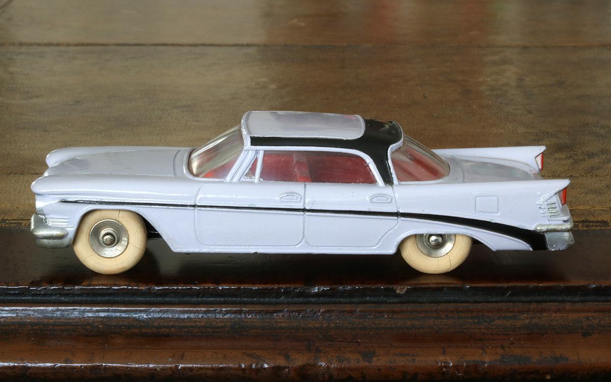

     First, a very nice writeup on this model, with lots of history to learn about it.  That sure is strange that they showed it so often in colors never used.....interesting and you have to wonder why?  And Jan, so nice to see your very original example still in such great conditon....even that box is better than most.
     I finally bought one of these a few years ago, partly because I happened to like that era of Chrysler cars, but also I wanted to sample just what these later Dinky Toys had to offer.  My main collecting interest runs to about 1959, but the past few years I have strayed a bit into some of the early 1960's offerings, mostly out of curiosity.  I am posting a photot mine, mainly to show those large white, lightly treaded tires.  I am assuming that those were later than the large white, smooth version.  I also like these treaded tires better than their English counterparts from the late 1950's, that have such large treads, very unattractive on automobiles.  As a side note, mine does not seem to be suffering the lower rear end sag as much......so far at least!
      Best regards,  Terry
Terry-Your model looks beautiful and the bottom of the chassis can indeed be seen in a beautiful horizontal line.
Nice to post a picture of this model with treaded tires. I also love more of the treaded tires than the smooth tires. It is prettier to see.
Best regards, Jan Oldenhuis

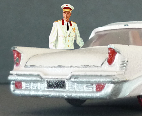

Jan, very interesting post!
Note that the doorman in the sales brochure doesn't have any legs, simlar to this picture from an ad.

Ragnar-A very nice picture. Congratulations. You fixed it very well wink.

The drawings on the boxes and catalogues were often made from the wooden mock-up but the mockup of the Saratoga has not been painted and is still so.
When a new model was to be issued, things had to go fast : getting the mock-up from a subcontractor modelist company, drawings of the casting and base plate, drawing of the die or dies, testing and modification of the die, printing of the boxes and catalogues, casting and assembly of a pilot lot, painting of the pilot lot in various colours, most of them ending in the local dump, choosing the colours of the final models etc.... A lot of work in a minimum time.
This explains why the boxes and catalogues were odered from the printers before the final colours were choosen. These documents were printed with any colour possible.
The diamond hole in the boxes is mainly economical as a single box type can be used what ever the colour of the model. This avoids stocking different boxes according to the colour of the model in the box. It is also economical for the collectors who do not have to search boxes with the correct colour spot.

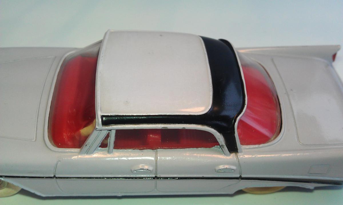

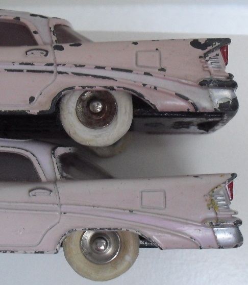

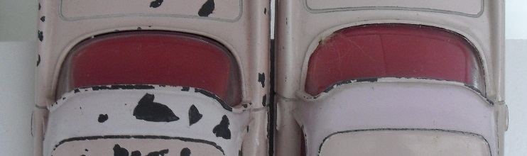

I discovered today, that the die was modified during the Saratoga's life.
Have a look on the photos bellow
Well noticed!  Interesting to see that the Saratoga received this amendment due to an ejecting problem that was encountered.  Is the same modification carried out with the interior of the roof and boot/trunk also?
I have never added the Saratoga to my French collection but looking at some of the images above, the hubs are very similar to those used with the Mercedes Benz 186, Holden 196, and other Liverpool models of that vintage, or am I mistaken.
Cheers
Bruce H.   (150)
20172905/1113/1037
This modification is due to an injection problem not ejection.
A die has to be polished very well, with wear of the die the polishing goes and the metal does not flow so well leaving spiral marks on large surfaces. Castings with such marks are recycled and cost time and energy. When too many models are cast with such marks, cross hatch is added to the mould or the mould is scraped.

Right Jacques.
Bruce : same modification for the ceiling only.

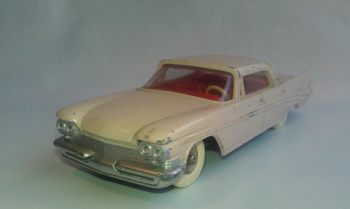

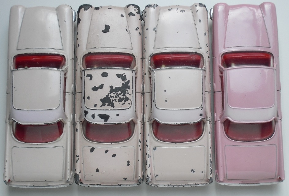

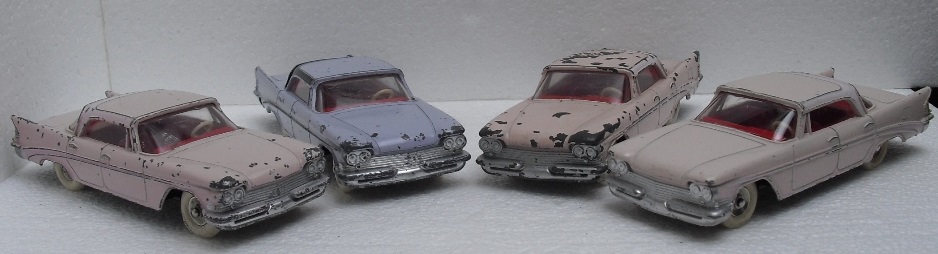

To complete the post, the photos below show my models and the white shades.
On some items the coat of white paint is so thin that it does'nt cover enough the pink and the result is a pale pink.
Kind regards to all.

With my new arrival, I could not do anything else that to add a new photo wink
We can see the variations of pink !surprisesurprise
Richard,
The paint manufacturer was not very good.
... and probably that the buyer in Meccano received nice gift for Christmas !wink
