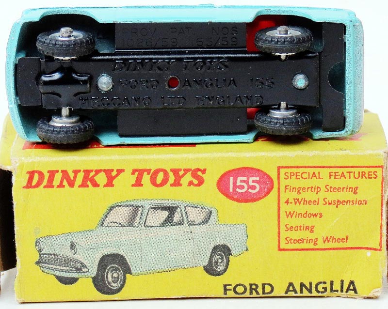

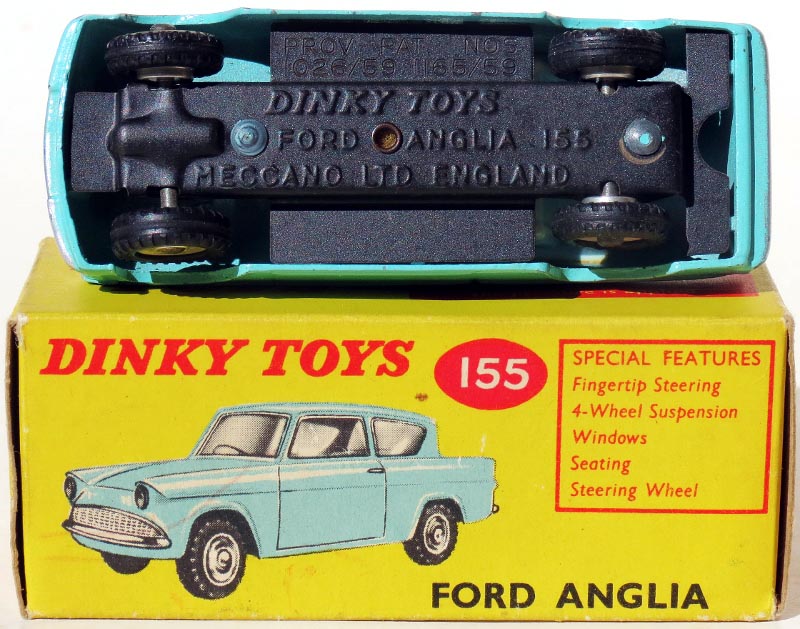

I am reviving this thread, as it has great potential, especially when black matt tin plate base plates have replaced gloss tin plate base plates, or used in tandem.
I am kicking off the revival with the 155 Ford Anglia that came in both styles:
First we have the shiny, gloss tinplate base plate with the red interior
Followed by the matt black base plate which is under the example with the pale blue interior.
It is unknown whether both base plates were in use for the 155 at the same time, or whether the use of the matt black base plate can determine a later time frame of production.
Kind regards Bruce
Good industrial practice is to have double sourcing for every thing. This allows to overcome overbooked supplier, industrial actions and to play a supplier against the other for prices.
My opinion is that one of the tinplate supplier could provide pree enamelled rolls of metal and the other was making mat black heat treatment which may be called Bruno finish or brunofix.
If I am right both finishes could be made available at any time during production of a model and any combination of colour, interior, hubs and tyres can be found.

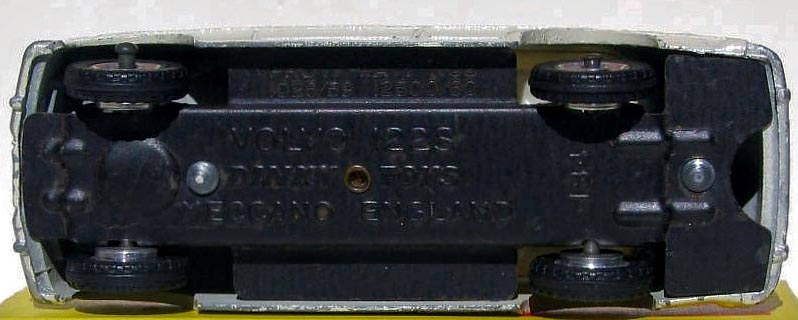

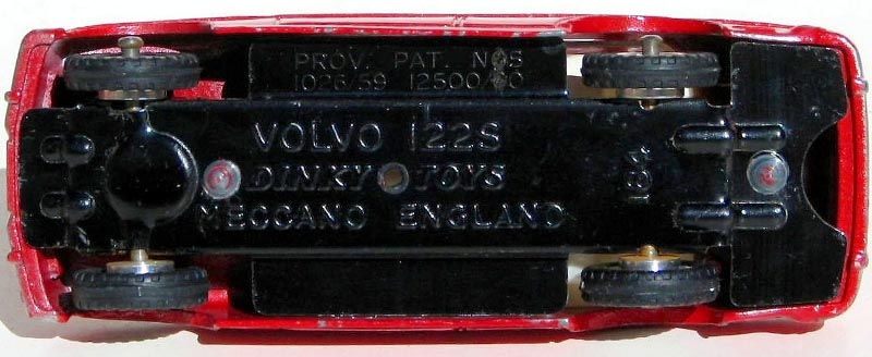

A further example of a matt base plate and a gloss base plate used with the 184 Volvo 122S in answer to your 2nd question above.
The top image is of a white Volvo. I have had two of these and both have the same matt base plate.
The bottom image is of the normal red version, and every example I have of this model has the gloss base plate. One can draw one's own conclusion!

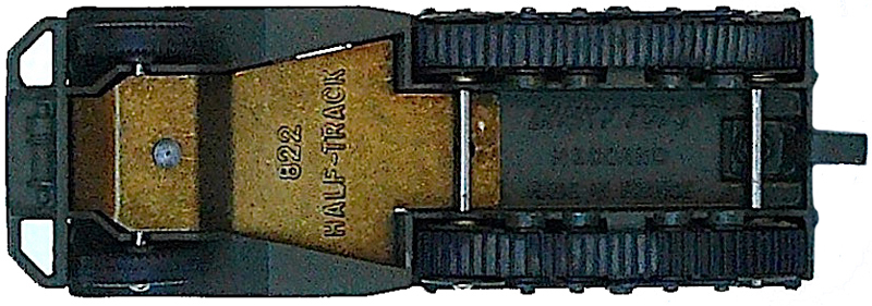

822 Half track M3.
What about this one with a yellow baseplate which is probably dichromated ? It is the first such base plate that I have seen, in fact I have only seen this picture and the model is under investigation 300 miles from here.
More about it later.

I have not seen an 822 with that type of base plate - all those that have come and gone through my hands have been the normal gloss plates, although one does appear to have a satin finish although that could have been as a result of how I photographed it at the time as well as the lighting conditions.

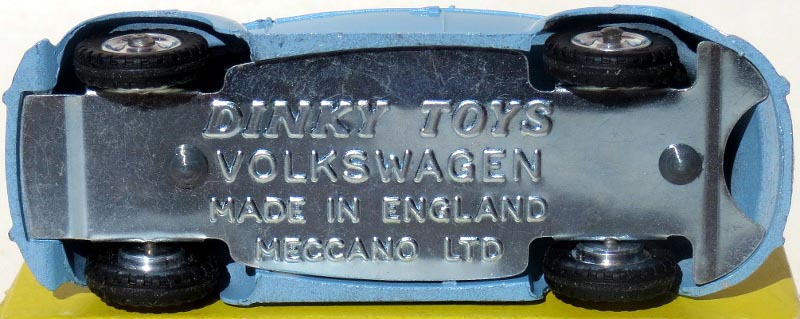

I am aware that this thread is all about MATT base plates, but thought I would throw in an image of the 181 Volkswagen with a plain/silver base plate and no sales number. (Would I be correct in saying that the 181 was the only Dinky to have an unpainted base plate?) The 181 Volkswagen has both gloss and matt base plates, as well as the unpainted base that came with the light blue with spun hubs version only, although there may have been other colours with an unpainted base plate, as nothing with Dinky Toys is definitive! I have not seen a matt base plate on a 181 either for that matter but that does not mean there are none "out there"!
Bruce,
I have seen that VW before, a late issue with spun hubs, no reference number and no bump above the Y of DinkY on the base plate.
The use of the bump has still not been explained. It is probably a positioning device for positioning the base plates at each step of the stamping.
The stamping is made in several actions on the same completely automatic machine. A reel of tin plate already lackered, varnished, brunofix or what ever treatment is fed into a stamping machine.
1) The first pressing emboses the marking and cuts most of the plate which is still attached to the steel reel. On raising the tool, the reel is moved one step.
2) The second stamping folds the plate and does operation 1 for an other base plate and on raising the tool, the reel is moved one step.
3) The third stamping cuts the base plate loose from the reel and does operation 2 for an other base plate and 1 for a third plate. on raising the tool, the reel is moved one step.
I suppose that the base plate of your VW is not made of bare steel, there must be some sort of anti-rust treatment.
I can not change the title of this thread to "Base plates finish" as all the messages would be lost.
I am sure that other members will apreciate your VW.

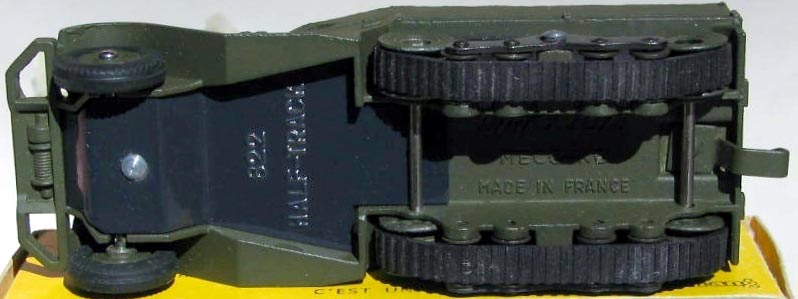

This is my 822 with satin (not enameled) base plate.
Thanks for the explanation on how the base plates are manufactured. Meccano would have had the making of these down to a fine art considering all the tin-plate products the company has manufactured for Hornby and Horny Dublo trains and their associated accessories.
No need to change the title of this thread as the 181 is reported to have matt base plates as well. I am hoping that members who have examples of the 181 with matt bases would submit a picture or two to add to this thread. I do not have a matt finish 181 in my collection - just the unusual bare metal base plate, so I decided to share this with the readers of this thread.
The below is of the 822 that I think might have a satin finish - but you no doubt can tell me one way or the other if this is correct! Unfortunately I am unable to examine it as it has gone to a new owner!
